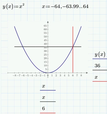

Mar 22, 2019 6:19 PM UTC
Markers without markers
Werner_E25-Diamond IAnswer
Mar 23, 2019 8:57 AM UTC
Raiko demanded "apart from using another data set".
There sure are workarounds possible similar to my grid making function for the native Prime plots, but the point is that the new, highly praised Charting tool seems not to provide a way to insert a marker.
This is ... surprising, to use a polite wording. Watching the "development" of Prime from the very beginning, it did not really surprise me, though.
