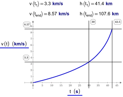

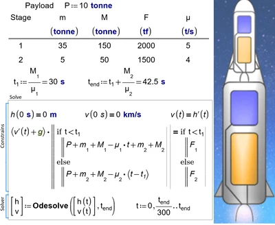

I am trying to set up an odesolve function with a mass spring damper where my spring constant is a piecewise function associated with position. Sort of like a mass is being driven by a force while being acted upon by a damper until it suddenly hits a spring. Any Ideas?
Best answer by Fred_Kohlhepp
Express can't use solve blocks.
Does this give you a place to start?  (Sorry for the mess--this was a work in progress.)

Odesolve with if - one example
