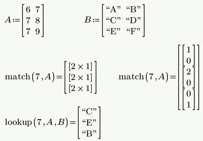

Match gives the location(s) (index/indices) of the element(s) found, while lookup gives the value(s) of all/an element(s) in (a) location(s) that correspond(s) to the element(s) found.
With matrix:
tells you that the 2 is found at row position 1 in colum 0.
gives you the value in column 1 of that matrix, at the same row where 2 is found in the first column (column 0).
You can also get the value of the element found, by looking up in the same array as where you search...:
but the usefullness of this may be questionable.
As Werner shows, you get multiple results, if the value you look for occurs multiple times in the array.

match(z,A) returns a vector of indices of the position(s) z is found in matrix A
lookup(z,A,B) returns a vector of values from matrix B from the position(s) z is found in A
See the Prime help here: Lookup Functions
Simple example:

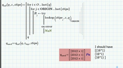

Jan 28, 2026 8:53 AM UTC
Hi Werner
I'm trying to use this function, that you showed me before
to get q in the corresponding ztips depth
I wrote it like this
can you tell me what is wrong with this program
Should I use match or change the iterator ?
I attached the sheet
Yusra

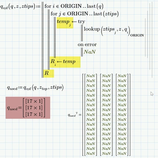

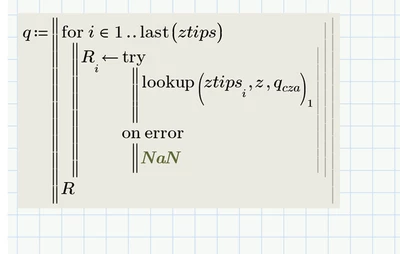

Jan 28, 2026 10:33 AM UTC
From the picture I see that your program does some calculations but at the end it returns "q" unchanged and that's what you finally get. 😉
Could it be that you are looking for something like this:

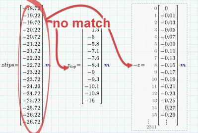

The results are all NaN's because none of the values in ztips matches any  value in the vector ztop (which is then called z in the program).
I also suspect that you meant to use -z when you call the program and not ztop (qused := qs;d(q.-z,ztips). But this does not change the NaN's because none of the values in ztips matches any value in -z as well.
At least i guess that the second argument when calling qs;d should be a 2312x1 vector like the three vectors in q and not a 11x1 vector like ztop .
I can't remember what the question was when I provided the function you refer to and what the data was at that time.and I don't know what you intend to calculate now. Maybe you need to use a modifier like "geq", "lt", "near", etc. (see the help), but I can't possibly know.
