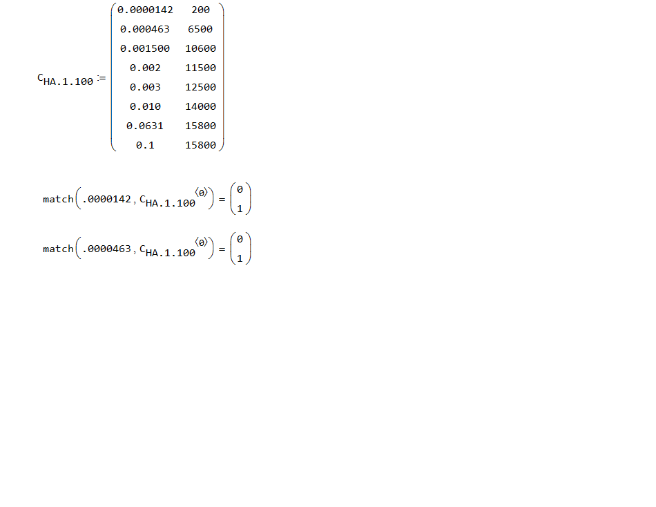

Can someone explain why the outputs to these match functions are the same?

From help:  The degree of precision to which the comparison adheres is determined by the TOL setting of the worksheet.
