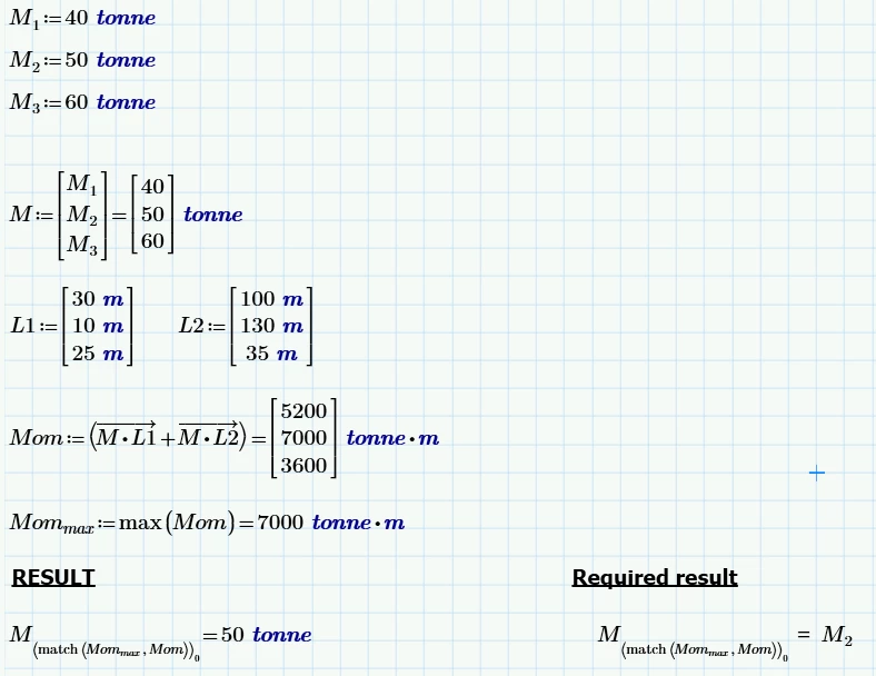

I'm not that experience with Mathcad, I do with excel, there the index match function is quite handy, something similar I would like to use in Math
I would like a lookup function in a matrix, to return as output from the matrix, not the value, but the name:
I'm not sure if it's even possible, have searched throughout the internet without results..
Thanks for helping!

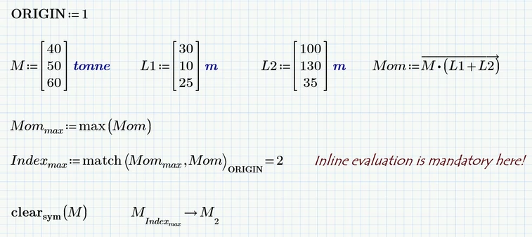

Simplification.
We can get rid of the Index variable, but inline evaluation still is necessary because "max" cannot be evaluated symbolically if units are used.

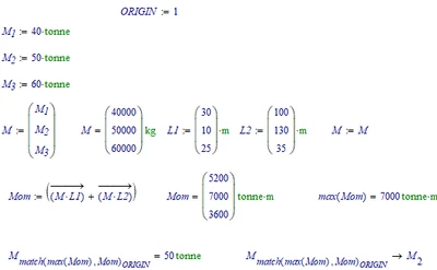

Does this do:
23-Emerald V

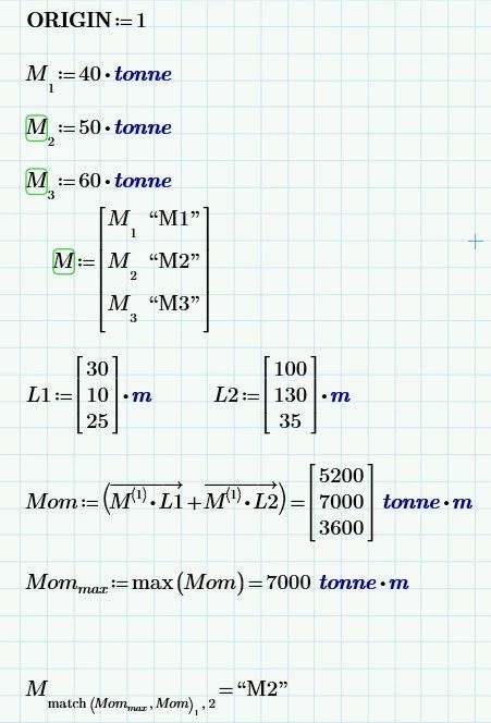

Like this... (in Mathcad 2001)
Unfortunately this functionality was lost in later versions of Mathcad, and Prime does not support it either,.

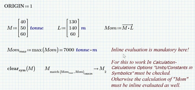

Jun 9, 2022 9:17 PM UTC
Your method works if we use an intermediate variable for the index which is inline evaluated numerically to stop the symbolics from trying to recalculate it.

Jun 10, 2022 3:23 PM UTC
Simplification.
