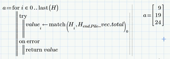

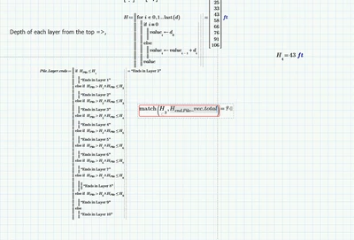

I have two arrays H and H_end.Pile_vec.total. I am trying to match the numbers between these two arrays and get the corresponding index number from H_end.Pile_vec.total. I have used the match function whic works for the first one only and not for the rest. Please help. My version is Prime 10.

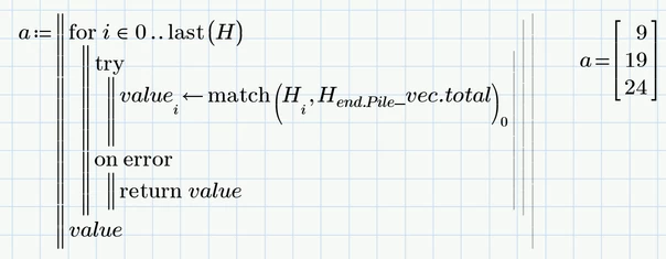

Hmmm, that way?
or maybe better
in case all values in H are to be found in H.end.Pile

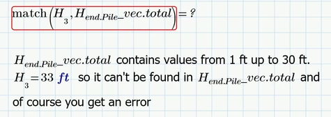

Its not clear what you mean by "match the numbers between these two arrays".
The error you get is easy to explain:
You will only find a match for the first three values in H and you can trap the error using "try...on error.."
So you would have to explain in more detail what you actually are trying to achieve.

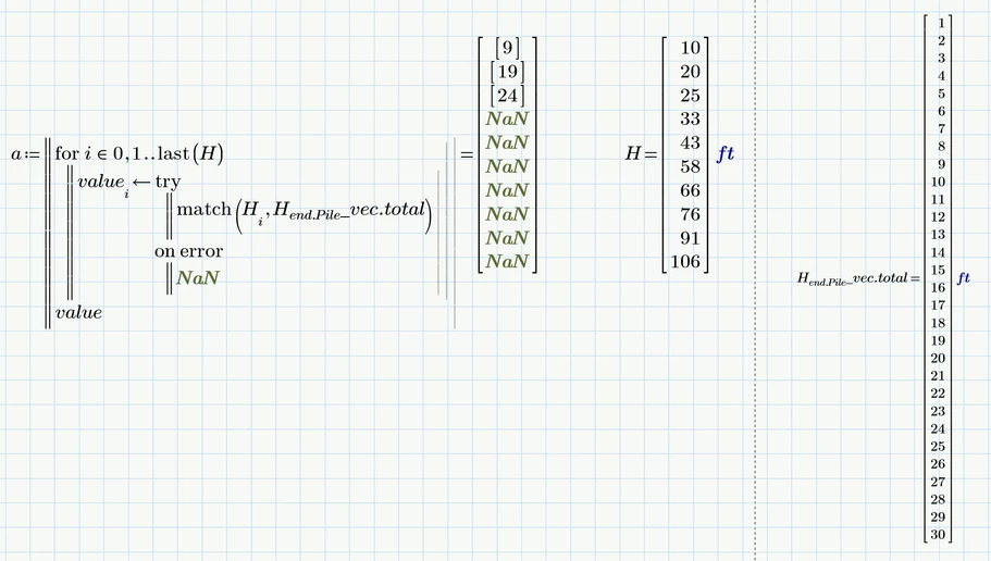

Thanks @Werner_E . This is what I needed. Based on H_end.Pile_vec.total, it will match with H and extract the indexes. How to stop at the last found index and not to show "NaN"s. Also, would later extract the arrays as values.
