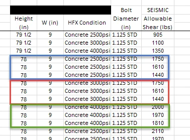

What you are looking for should be able to do with a routine from Richards fine collection of scriptable components (which I can't find now in this new, horribly forum) using Mathcad 15, bur not with Prime.
Your list includes a lot of duplicates concerbning the first four columns and the bolt diameter it "1.125 STD" throughout.
So which result do you expects with Height=78, Width=9, HFX Cond = Concrete 2500psi and bolt d. =1.125 ?

You are right, I forgot to add one more column. Plese see revised file. The table is much more complex but I was trying to simplify it. The idea is that no row repeats in a table of 1000+ rows.
