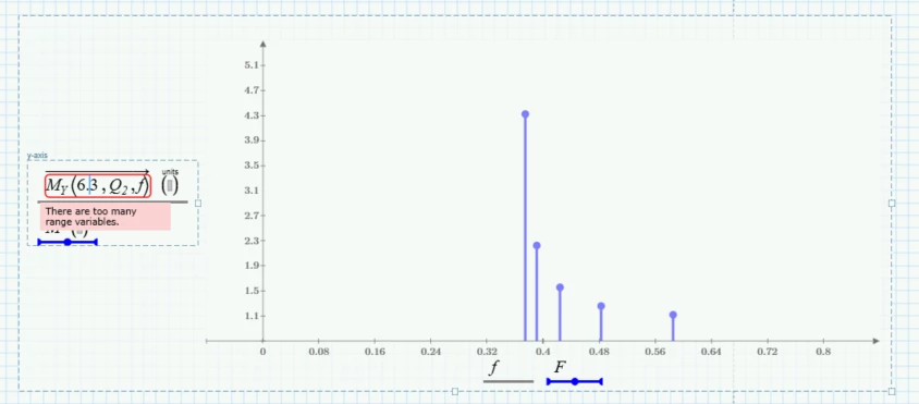

I converted your Mathcad 15 file to Prime 10 and...I see this. How to solve?
Jun 13, 2024 3:35 PM UTC
Yes, Prime is not capable to plot family of curves like Mathcad was able to do.
You would have to do it completely different, create vectors(/matrices and use Primes waterfall plot to get a similar picture.
Fortunately @J_power  is using real Mathcad and not Prime 😉
