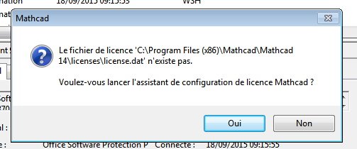

Mathcad 14.0.3.0 error 1904 install ocx in windows 7 64 bits What to do ?
I did before in Windows 7 64 bits  but  today now i can't install mathcad in windows 7 64 bits, it displays this 16 error on ocx files during the installation..
I have always a network licence that is working.
I have this error

same problem... i gave got this 10 messages afetr repair the installation
when u run mathcad 14 it says,
Mclicence stop to run ..

Please Help me to fix this ?  i cannot install properly Mathcad and when i run it  mclicence failed.
