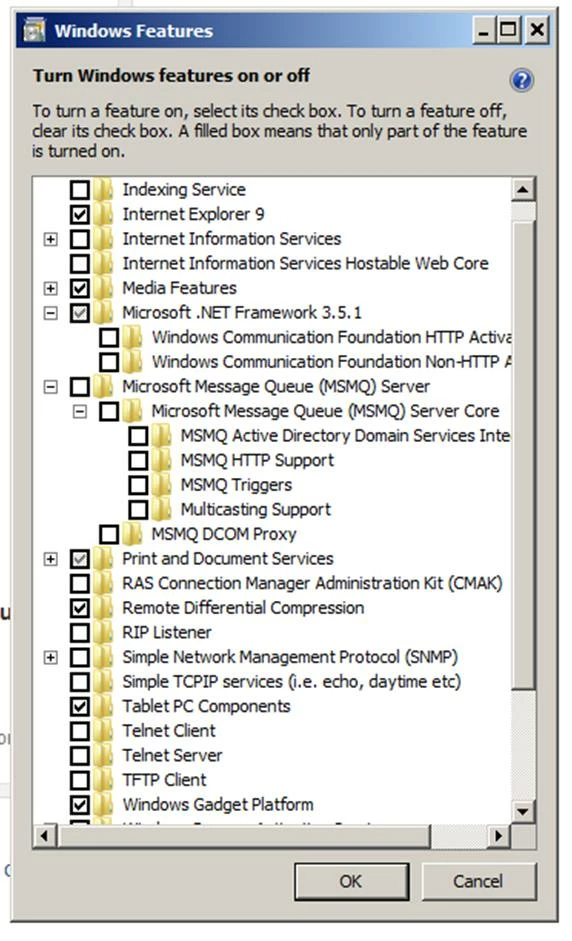

After a "clean" install of MathCad 14.0 M020 on Win 7 Professional (service pack 1) MathCad does not start.
I click on he Mcad Icon, the hour glass appears, and then vanishes. The error below is found in the WIndows even logs.
I did a complete uninstall, and deleted as many regsitry keys as I could find but after a reinstall the problem still persists.
mathcad.exe
14.0.2.5
47a9b0aa
KERNELBASE.dll
6.1.7601.17651
4e2111c0
e06d7363
0000d36f
117c
01cc6fd1a58bc63a
C:\Program Files\Mathcad\Mathcad 14\mathcad.exe
C:\Windows\system32\KERNELBASE.dll
e400e0ec-dbc4-11e0-a667-0026b9aa08f7
Anyone having a similar experience?

Hi Fritz,
See attached screenshot from my computer - these options are not activated so probably it is not a reason of your problems.
I am not sure that my problem was related to kernelbase.dll (it was about 1.5 year ago), but as I wrote earlier, for me helped installing my other software before installing Mathcad 14 M020.
Did you try to install all required components on fresh Windows 7 before installing Mathcad? or after installing Mathcad?
Jerzy

September 11, 2011
Please look at an inclusiveness of components of a .NET Framework & MSXML in Win7. It is possible to look at these components in "Cotrol Panel" - "Programs" - "Programs and Features" - "Windows Features". Further they can be activated, having put down a tick.

September 12, 2011
Thank you Vladmir.
I am running win 7. I searched about the C: drive, MyDocuments and so forth and could not find a ptcsetup.log or anything similar. I have attached the result of the Windows Features panel. Clearly some of the required features don't have boxes checked. Can you tell me which ones are checked on your system and I will try it (I am a little leary of turning them all on)-
I appreciate the information

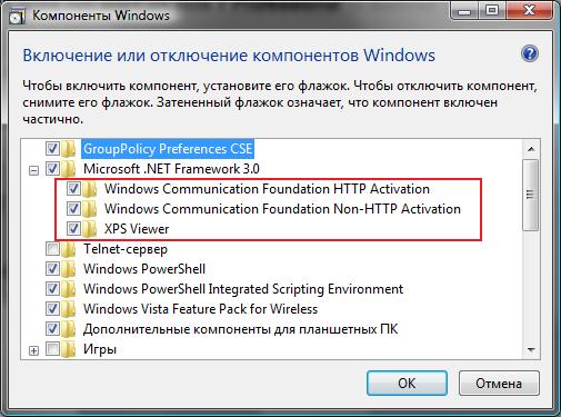

September 12, 2011
Fritz, hello!
You need to activate the following options. NET Framework (see screenshot):
