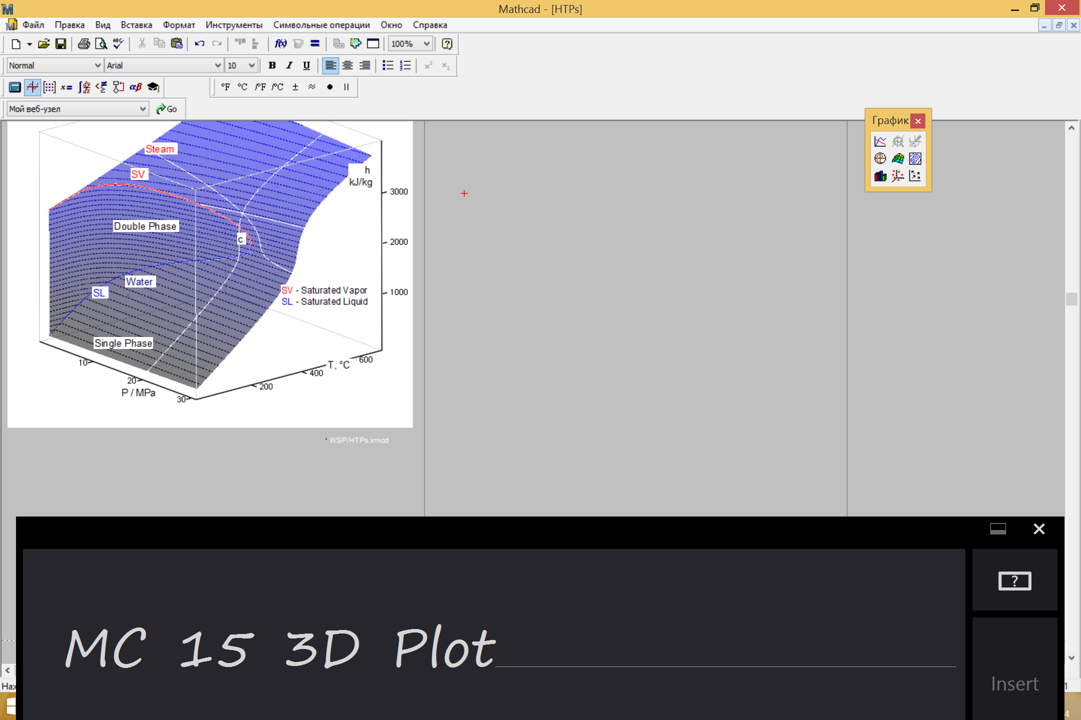

I have Mathcad 15 and Prime 3 on Surface Pro 3 with Win 8.1. All is OK!
Even the 3D plots? I remember you reported some time ago that 3D plots in MC15 did not work for you under Win 8 and the well known workarounds which used to do the job under Win7 did not work either.
Aug 28, 2014 6:05 PM UTC
I have one solution with Win 8.1:
