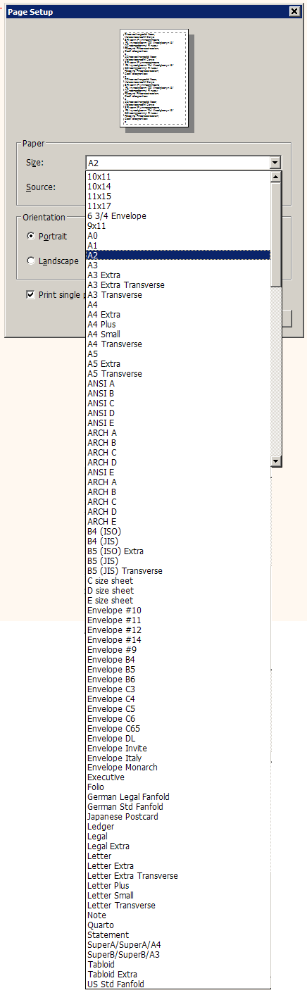

Its a while ago I used Mathcad 14 but as far as I recall there was not much difference to Mathcad 15 in that respect.
When I open in Mathcad 15 the Page Setup the drop down for Size offers me a lot of different paper sizes, but
1) I could select A2, its available
2) I dont see any Custom Paper Size entries
3) I dont see what size the selected paper actually is set to 😞

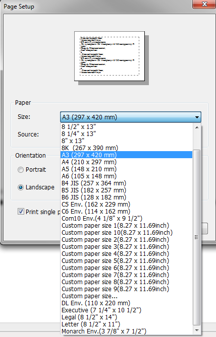

cberceanu1-VisitorAuthor
Dec 10, 2013 1:13 PM UTC
Unfortunately, I have different options (A2 missing and a lot of Custom paper size entries):
