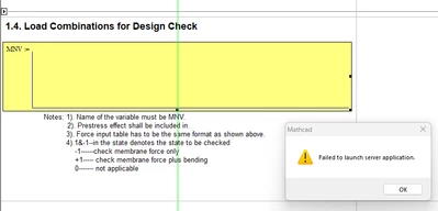

Mathcad 14. File attached.
I am trying to fill out this area which I believe launches excel and I get the following error:
I was looking at the forums and some people suggested using Excel 32 bit instead of 64 bt
but I already have 32 bit
before I go through the hurdle of asking IT to reinstall this software (which might not even solve the problem) what can I try?
thanks,
It seems you forgot to do that.
You screenshot doesn't really show if its really 32-bit M$O.
I remember some threads in the past claiming that Mathcad has problems with Office 365. But I think there also were answers stating that Office 365 would work OK for them.
I also remember the tip that it may help to manually fire up Excel, wait until its up and only then double click the embedded component (but then this may have been an old hint at the times computers were much slower than nowadays and maybe its just trying to avoid some kind of timeout).
Sorry, I think I can't be of much help with this...
