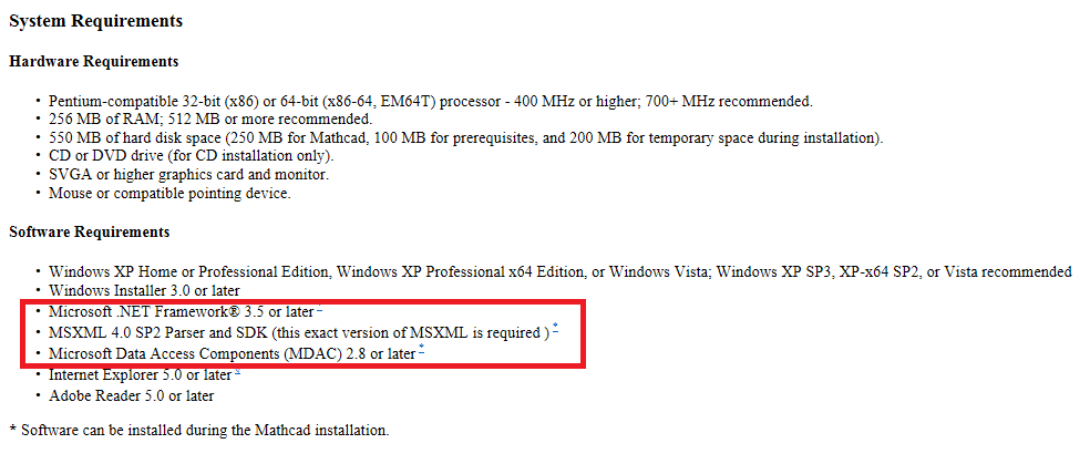

I've recently reloaded MathCad 14 onto my re-imaged Windows 7 computer on which it used to operate but the program will not start up. The icon on the task bar 'glows' and then dissappears without any request to find the licence. Has anyone come across this before and knows the answer?

Mathcad 14 should run on Win7 without problems (Mathcad 11 also ran on it).
Do you have the proper version of .Net installed? And the other prerequisites?

Thanks Vladimir. I think it is M020.  I went back to the MathCad CD and adding the MDAC program seems to have fixed it. The .net wouldn't go on as the error message said it was unsuitable for 64 bit.

Just note that the system requirements for Mathcad 14 are as follows:
Here you can find a "Release Notes" for Mathcad 14: Release Notes for Mathcad 14
