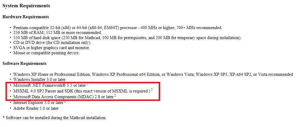

What Windows OS are you using? Note that the system requirements for Mathcad 14 are as follows:
Here you can find a "Release Notes" for Mathcad 14: Release Notes for Mathcad 14

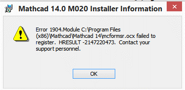

  1. MDAC 2.8 not found in my windows 8.1. So I  Installed it ---> still  the same animation glitch
  2. Also  located mcmreg.exe,   clicked on it to see what happens
  3. See pasted message  below
Gave a another try to repair M020 -- This time  it came up  with error., Attempted several times to Repair
same error  repeated  as shown below

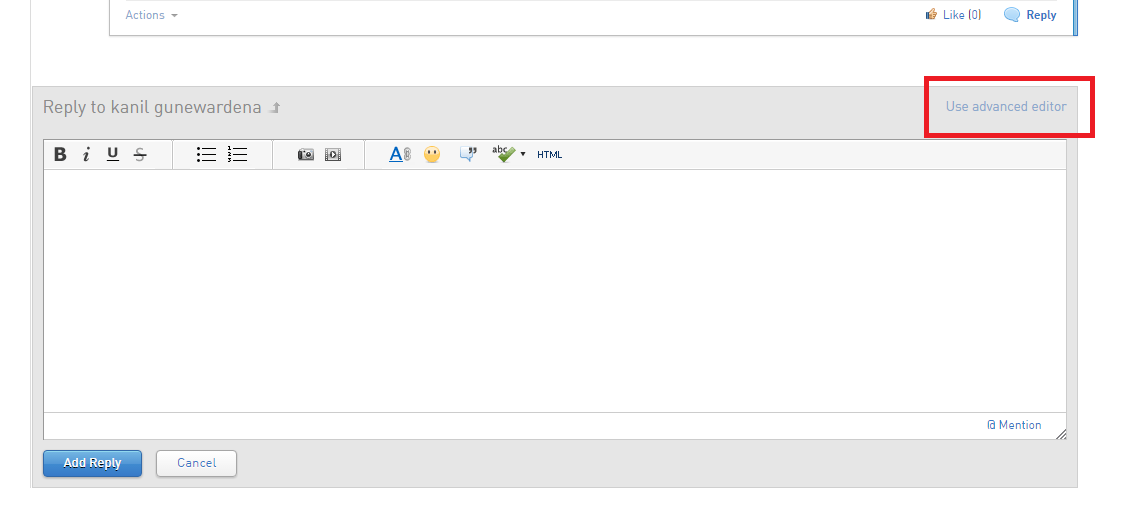

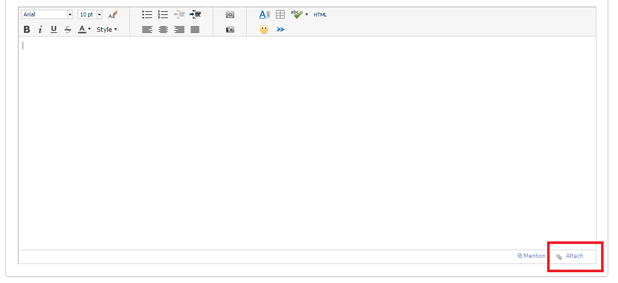

How does one  attach a file  from a directory on this reply page? - like you have done  (Pic_ 1.png)  , I do not see the option on the  tool bar

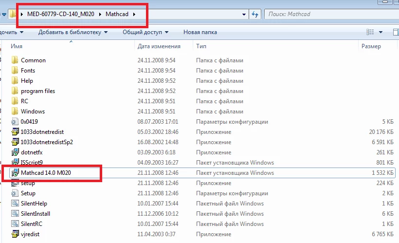

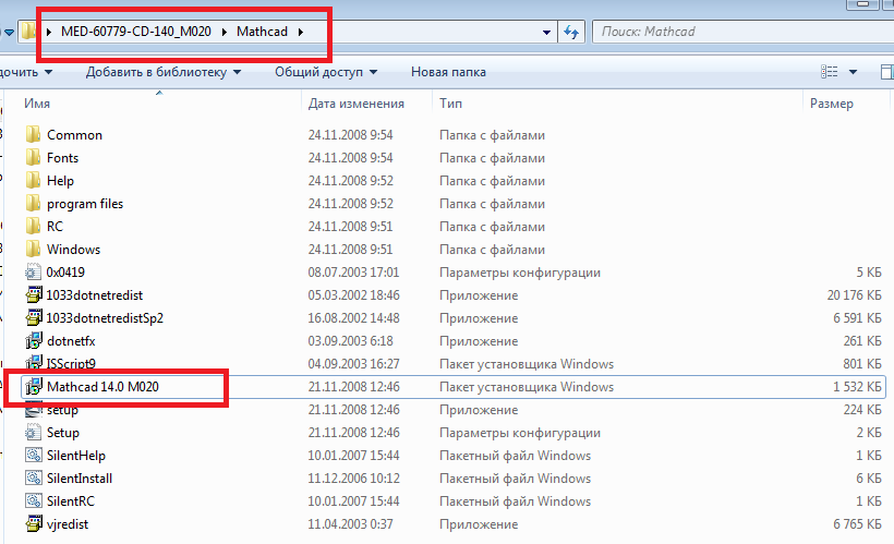

2. Install Mathcad by using "Mathcad 14.0 M020.msi" "silent" installer. If errors appear, then just kept hitting "Ignore"/"Ok" until the installation completed. Opened up "Programs" in "Control Panel" clicked on "Mathcad" and select "Repair".
3. For uploading a files use "Use advanced editor" option and then click on "Attach" in the lower right corner:
