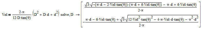

I have an equation with one unknown variable which I'd like to solve for, but I get an error "No solution was found".  I can make a function with the variable and it will solve for any value, but when I try to use 'solve' it finds no answer, see below.
What am I doing wrong?

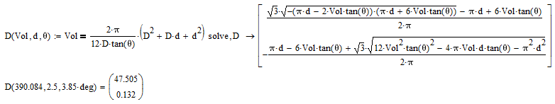

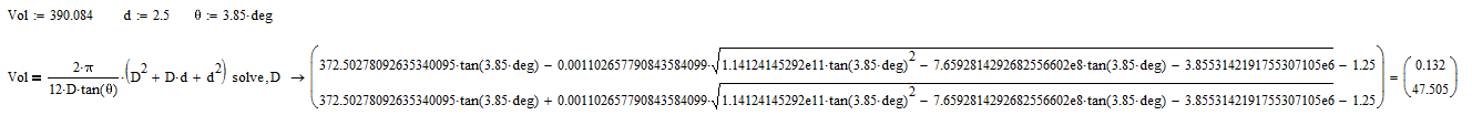

You've already defined D and Mathcad is trying to use it in the solve equation.
Here are some options that don't result in error:
MJG1-VisitorAnswer
November 2, 2016
