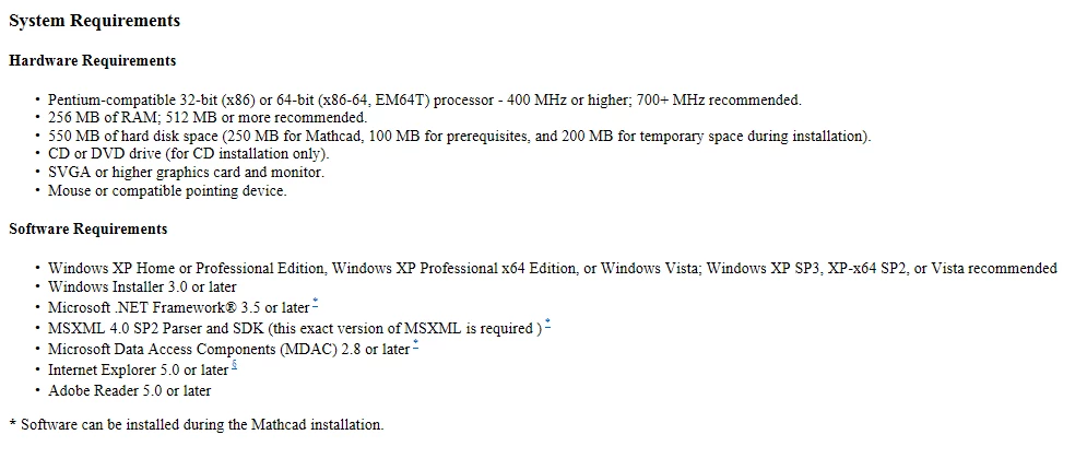

Officially, the system requirements for Mathcad 14 are as follows:
Here you can find a "Release Notes" for Mathcad 14: Release Notes for Mathcad 14
