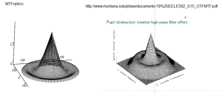

Hi, I am trying to convert an MTF of an optical system by taking the magnitude of the fourier transform. I have attempted this but the result doesn't look like it should.   I cannot see any obvious mistake.
I appreciate any help,
thanks

psf = point spread function
mtf = modulation transfer function.
psf is used in the spatial domain to indicate the smallest object an imaging system can deliver.  The MTF is the equivalent but in the frequency domain.   The beauty of working with MTF's is the response from different components (optics, detector etc) can be obtained by cascading the MTF's.
The psf is the magnitude of the FT of the MTF.  But something doesn't appear right in my implication of this.

I'm not sure, like Luc I'm in uncharted waters.  But a quick google search turned up
Formally, the OTF is defined as the FFT of the (PSF, that is, the of the optics, the image of a point source). As a Fourier transform, the OTF is complex-valued; but it will be real-valued in the common case of a PSF that is symmetric about its center. The MTF is formally defined as the magnitude (absolute value) of the complex OTF.
So your claim that the PSF is the FFT of the MTF sounds backwards. . . .

I'm not surprised.  If we believe Wikipedia (if it's on the internet it must be right!) the MTF is the amplitude of the OTF, so trying for an inverse FFT of that would be a challenge.
I've done a bit more research, http://www.montana.edu/jshaw/documents/18%20EELE582_S15_OTFMTF.pdf does a pretty fair (from a layman's view) job of showing the relationships.  Comparing your MTF to one of theirs shows a similar construct:
