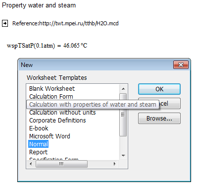

One esample of using a template with properties of water and steam

Hi Valery,
Thanks for the reply but that's not quite what I mean.
I wanted to know if there was a way to get Mathcad to be directed to a template folder stored on the network, rather than the one on my C drive, when I click on "new"
July 1, 2014
