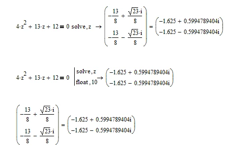

May 6, 2015 9:13 AM UTC
Richard,
In the screenshot I showed the possibility of using the symbolic operator "float", and only the user will determine the accuracy of the calculation which it requires (n = 3 - shows as a simple example).
