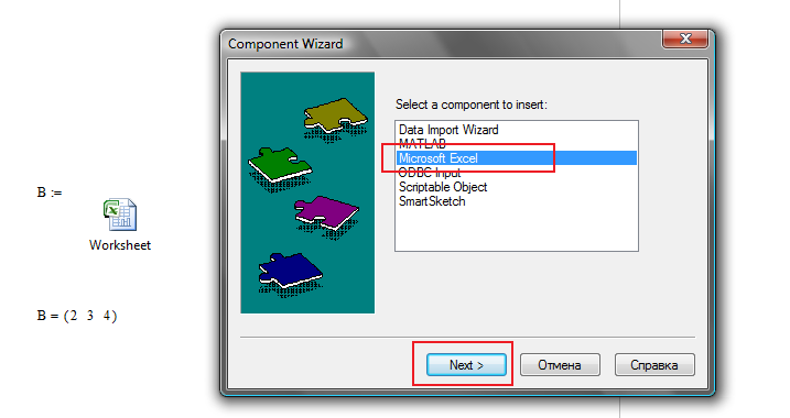

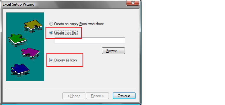

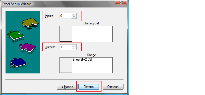

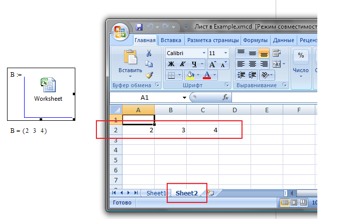

Hello!
cecile airo wrote:
But it failed when I use a PC with Windows XP, Mathcad 15, Excel 2003 (.xls) : the function readexcel returns "corrupted data" when pointing to the .xls file ; the problem is : the application have to be used with the "WindowsXP, mathcad15 and excel 2003" configuration (because it's the client configuration).
You need to use the following: in main menu select "Insert" -> "Component" -> "Microsoft Excel" (to specify an Excel worksheet, use the command ("SheetN!", where "N" - number one of the sheets in your Excel file)):
February 1, 2012
The problem with this approach is that the Excel worksheet becomes redundant and cannot be changed via Excel, so if further data is required a new worksheet will have to loaded.
Also, you will be increasing the size of the Mathcad file because you are holding all the Excel worksheets inside Mathcad.
A decent workaround though.
