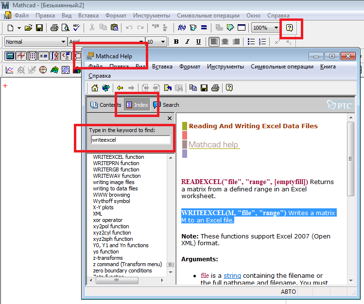

May 18, 2016
If so, then use WRITEEXCEL(M, "file", "range") - writes a matrix M to an Excel file.
