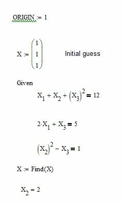

Mathcad 15, find just one variable
I want to simply find one thing.
I have a rather large system fo equations and I just want to find one answer.
Is there a way to put a single variable in a find statement.
So if I have a system with X1 X2 X3 ...... X100
I don't want to have to have the following.
A 100X1 := find(X1......X100) Its unmanable because all it does is run all over the page.
I used to be able to do this in prime.
I simply want to be able to find one variable.
Answer := find (X33)
How can I do this in 15?

Do you mean you have 100 simultaneous algebraic equations in 100 unknowns and just want to find one of the 100 from a Given ... Find solve block.
If so, you can do this by representing your 100 X's as a vector.  You need to solve for all 100, but can simply extract the one you want, and you don't have to write a huge list of values inside the Find expression.
Here's an example with three Xs (because I'm not spending the time to do 100):
If this isn't what you mean, then you will need to explain your problem more clearly.
Alan
