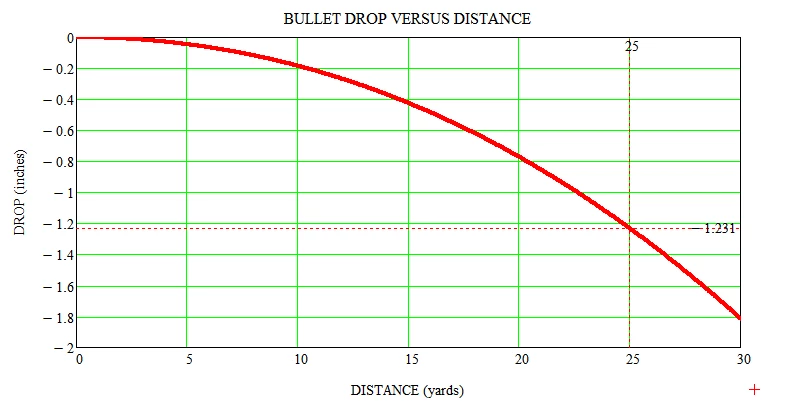

In the attached Mathcad 15 file, I have somehow enlarged the label fonts.  I cannot recall how I did this.  Can anyone find the setting I used to change the 2D graph fonts?

Thanks.  Here is how it looks on my PC.  I used an existing Mathcad 15 file that uses larger labels.  I have no idea why this file gives larger graph fonts.
Notice the larger fonts.

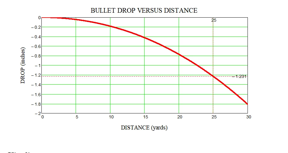

This is how it looks if I generate the Mathcad 15 file from scratch.  These are the normal "smaller" fonts. 🤔
