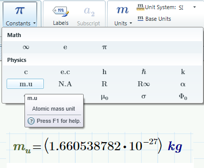

January 24, 2012
The amu is a built-in unit (constant) in Mathcad Prime:
