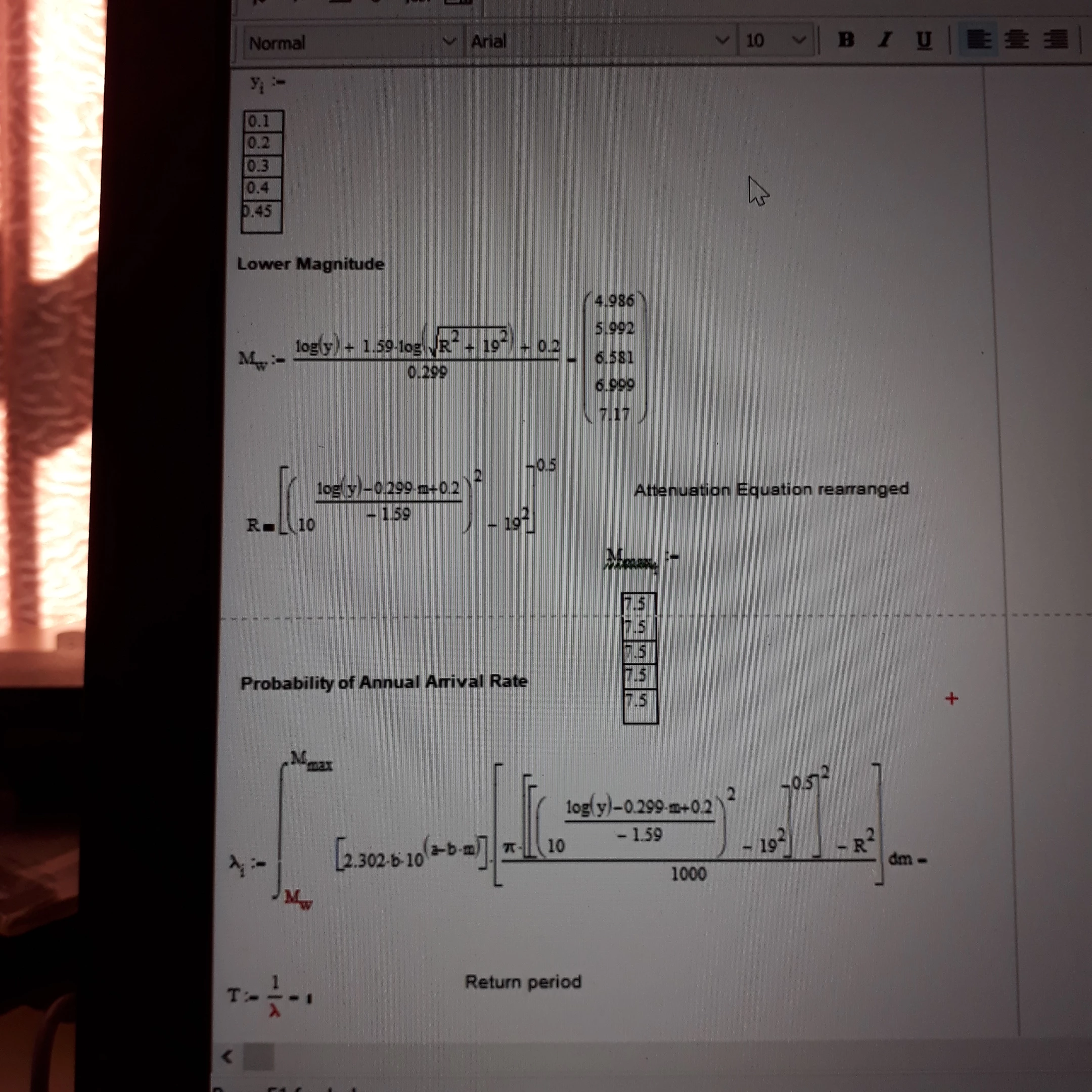

How do we write function to accomodate range of min and max .. in an interation function. Please see attached.
I have list of Mw and Mmax values that i want to intergate all at once so that i can later use to plot a  graph.
Please help.

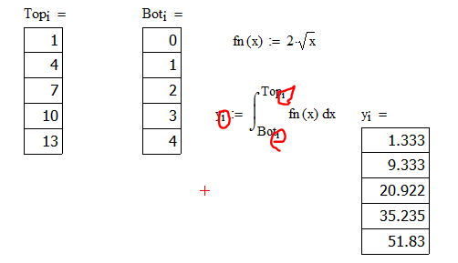

Add indices to your integration limits:
