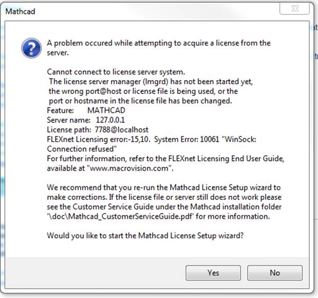

can anyone help? i want to transfer my mathcad 15 license to another computer, however when i use the license transfer function/reconfigure tool the mathcad 15 doesn't show up in the license report and isn't listed as an option to transfer (only my Prime Licenses). is there any other way to transfer the license to another machine?

have been looking in to it further and seems i should be able to use mathcad 15 on any of the machines that are currently running Prime 2.0........however it appears the problem is a flexnet server error.
Any of you come across this before? any ideas other than renew my maintenance contract and ask Tech support?
thanks
May 19, 2017
Do you really have a license server running locally on the very machine you are going to work with Mathcad?
Otherwise you should check your settings.
You may also set the environment variable LM_LICENSE_FILE like
set LM_LICENSE_FILE=7788@flexlm_server1.mycompany.com;7788@flexlm_server2.mycompany.com
to point Mathcad or Prime to the license server(s) you are using.
If you click yes at the message you get the license setup should come up, to give you the opportunity to tell it to use an existing license and then point it to the license file or the correct license server.

i have tried to use the option to point it to the license file but then i cant find the file to direct it to. do you know what the file path to the license file would usually be for Prime 2.0?
