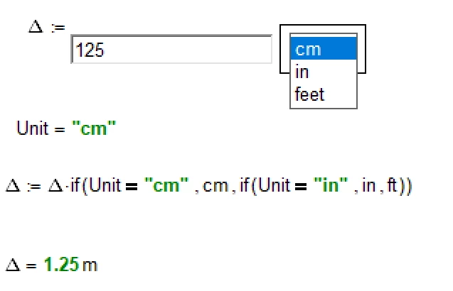

November 23, 2020
See pls pic and attach
