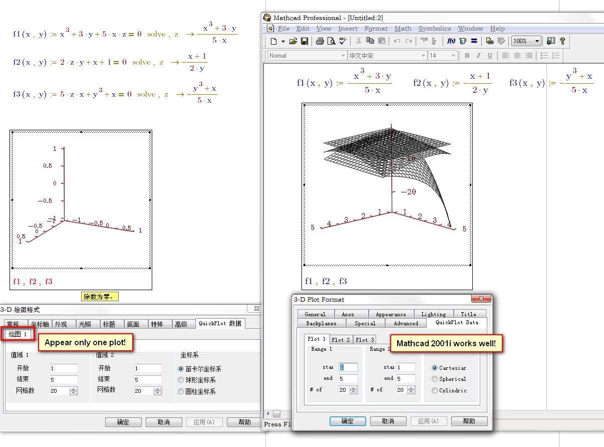

I want to draw 3 expressions in one 3D plot, and the ranges of x,y is 1~5.
When I draw it in MC15M030, only one plot setting item appeared!
And when I use the same function in MC2001i, it work well!
See the picture below:
It seems a bug in Mathcad 15 M030, is it?

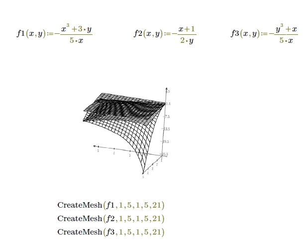

Another way out is using createmesh.
As Prime did when I converted the file?
Yes. In Prime we can only set the "quickplot" ranges by awkwardly changing the values on the axis. I still scratch my head about the fact that there must be at least one person who thinks that that kind of user interface is a good idea - its so awful!
So in Prime in contrary to Mathcad you are not allowed to set different quickplot ranges for different plots and so Createmesh has to be used to simulate this.
So Prime can't suffer from that bug because it does not even offer the feature which fails in some cases in Mathcad.
