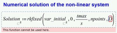

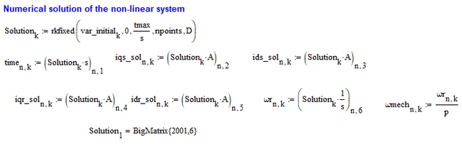

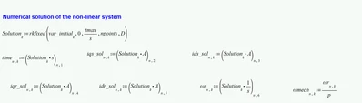

the reason of my posting is an failed conversion of a MathCAD 15 file/model to MathCAD Prime 7.0
In particular this Model contains a quite complex differential equation, and after using the converter the new MathCAD Prime 7.0 model output an error on the command line which should start the solver (in this case it is the rkfixed, but the same error occurs also with other solvers. The red mark of the error is put on the "D" of the beforehand differential equation, the error report is (in german) "Ein_Aufrufziel_hat_einen_Ausnahmefehler_verursacht." This means something like "a call target has caused an exception error" (I do not know the exact error description in the english version).
As MathCAD 15 is terminated by the supplier, we need a solution to further operate this MathCAD model.
Attachment: The MathCAD 15 file and the MathCAD Prime 7.0 file after conversion. The said Differential equation ist given on Page 13...15 in MathCAD 15, on Page 16...18 in MathCAD Prime 7.0 after conversion.

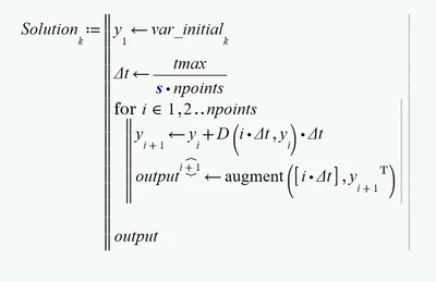

I finally found a way of getting Prime to integrate your DE - but I had to ditch their integration routines (Adams, Rkadapt, Radau) all fell over and so I used a mickey-mouse box car integration scheme :

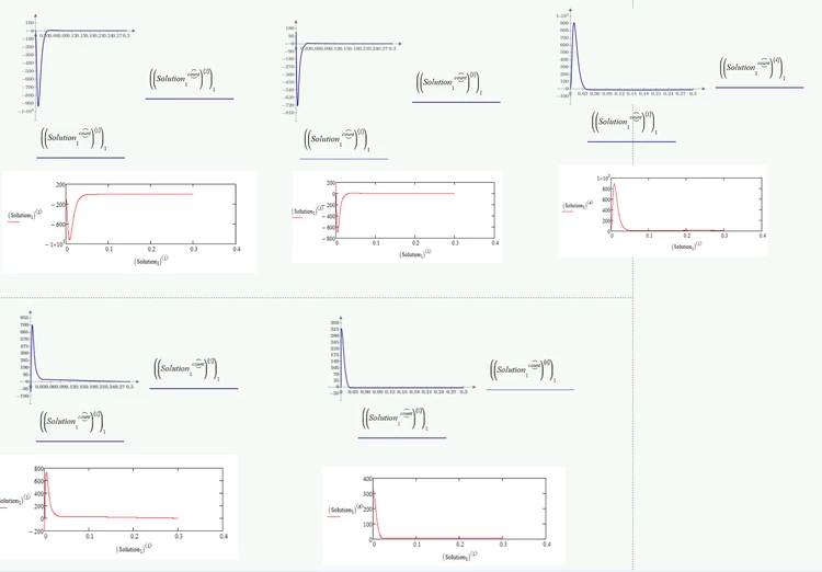

This resulted in Prime vs MC15 comparisons on the first Solution:
The file and pdf are attached.
In trying to get Prime to work I made the following modifications in the hope that it would wake up (without success):
1) added units to all zero quantities (Prime can be funny about not putting units on zero quantities)
2) swapped signum for sign - (may give problems if you get imaginary currents)
3) changed the symbology to use D(x,y) - I have found issues with naming in DEs
4) Nondimensionalized the arguments to the Vd() function
Geoff

Unfortunately I can't help.
I can only confirm that Prime shows an error. I converted the MC15 file using Prime 6 and the error message is different
