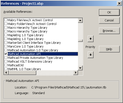

I am using Mathcad 13 - VB 6.0 OLE automation for calculations.
Everything was working fine till now. We are planning an upgrade to MathCAD 15.
When I tested the same VB application on MathCAD 15 version am receiving the following error. See the attached screenshot.
System Config: Windows server 2008 standard 64 bit, VB 6.0, Microsoft Office 2010.
Please let me know how can I resolve this issue.

Private Sub cmdCalc_Click()
Dim Var1 As New Mathcad.NumericValue
Dim MathcadApplication As Mathcad.IMathcadApplication2
Set MathcadApplication = New Mathcad.Application
MathcadApplication.Visible = False
MathcadApplication.Worksheets.Open "d:\TestMathcad15.xmcd"
Var1.Real = CInt(txtval.Text)
MathcadApplication.ActiveWorksheet.SetValue "A", Var1.Real
MathcadApplication.ActiveWorksheet.Recalculate
Var1 = MathcadApplication.ActiveWorksheet.GetValue("B")
txtOut.Text = Var1.AsString
Set Var1 = Nothing
MathcadApplication.ActiveWorksheet.Close mcDiscardChanges
MathcadApplication.Quit
End Sub

This is the same computer that you yested it on with MC13, and with MC13 it worked?
Oct 5, 2012 12:52 PM UTC
Yes. It gave perfect results with MC13. I have tested it on the server.
But, When tested the same application on MC15. It is giving the error mentioned in the earlier message.
What do u think may be causing it?
Oct 5, 2012 1:55 PM UTC
I don't know. Do you really have an object called "~", with a method called "~"?
