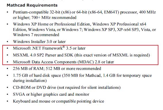

Dotnet versoins are not backward compatible. You need the specific version that the application targets, which for Mathcad 15 is version 3.5.
Dotnet 3.5 is already installed with Windows 7, but maybe it's turned off. I don't have Windows 7, but I believe you can check this under Control Panel, Programs and Features, Turn Windows features on or off.
You can have mulitple versions of dotnet on the same computer.

For work Mathcad 15 on the computer should be preinstalled the following Microsoft components:

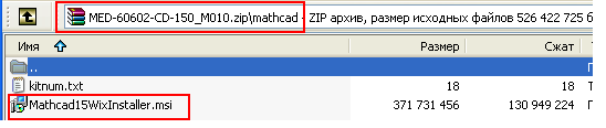

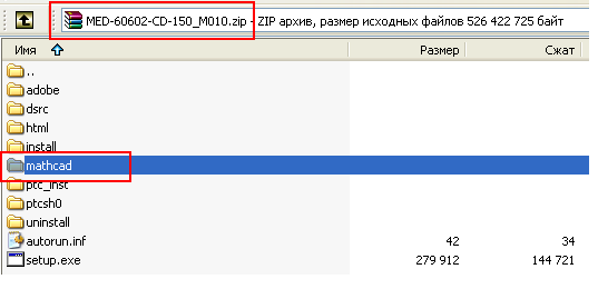

What kind of service release of Mathcad 15 (F000, M005, M010) you mean? Try to make a "silent" installation using the installer "Mathcad15WixInstaller.msi" from the folder "mathcad" (from ZIP Mathcad package):
P.S. Did you report this problem to the PTC's tech support ("Log a New Case")? Here: http://www.ptc.com/appserver/cs/case/case_logger.jsp
(or, by using "Mathcad Support Center": http://www.ptc.com/support/mathcad_supportCenter.htm)
