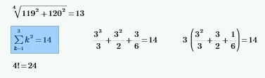

November 8, 2021
Here's your '24' (Note that time 24:00 equals 00:00):
OK, I'll add 23 as well:

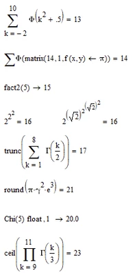

November 8, 2021
IsPrime(1) -> 24
previousprime(19)  -> 17
23-Emerald V

November 16, 2021
Here a few more
November 17, 2021
OK, here's another 15, playing around with the numbers 1,2,3,4
Or more simple with 1,2,3
Oh, and here is 14 using three times the 4
November 17, 2021
Here's 18 for you:
And the next:
