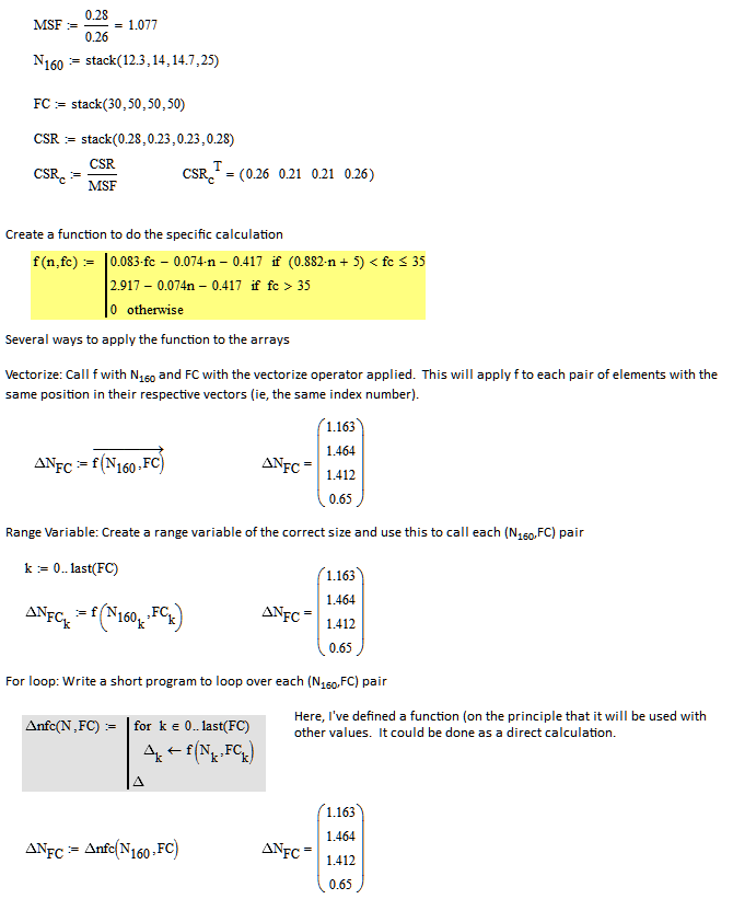

I'm trying to simplify the following calc to compute the fines content correction as a 4x1 matrix but continue to get error after error when I try to write for loops. Please help...

Is this of any help?
Stuart

October 14, 2015
Yes thank you!
