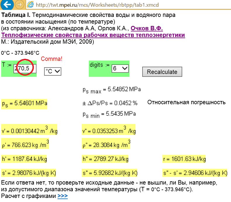

May 26, 2015 6:28 PM UTC
You can input on my Web-sheets (Mathcad Calculation server) comma or point.
Try please http://twt.mpei.ru/mcs/Worksheets/rbtpp/tab1.xmcd
You input number as a string than a little utility convert it into number: 5,5 ->5.5   5.5 ->5.5
