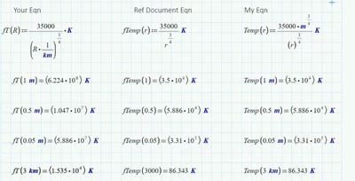

I have a question.
From the reference document
Problem 1 - Sketch a life-sized illustration of the gas surrounding the above black hole
and give the temperature at a distance of 1 meter, 50 centimeters and 5 centimeters from
the center of the black hole.
Answer: At 1 meter, T = 35,000 K, which is 6 times the surface temperature of our sun.
At 50 cm or 0.5 meters, T = 59,000 K.
At 5 centimeters or 0.05 meters, T = 331,000 K
Using your equation i get a different answer
Your thoughts on my equation. Thanks.
