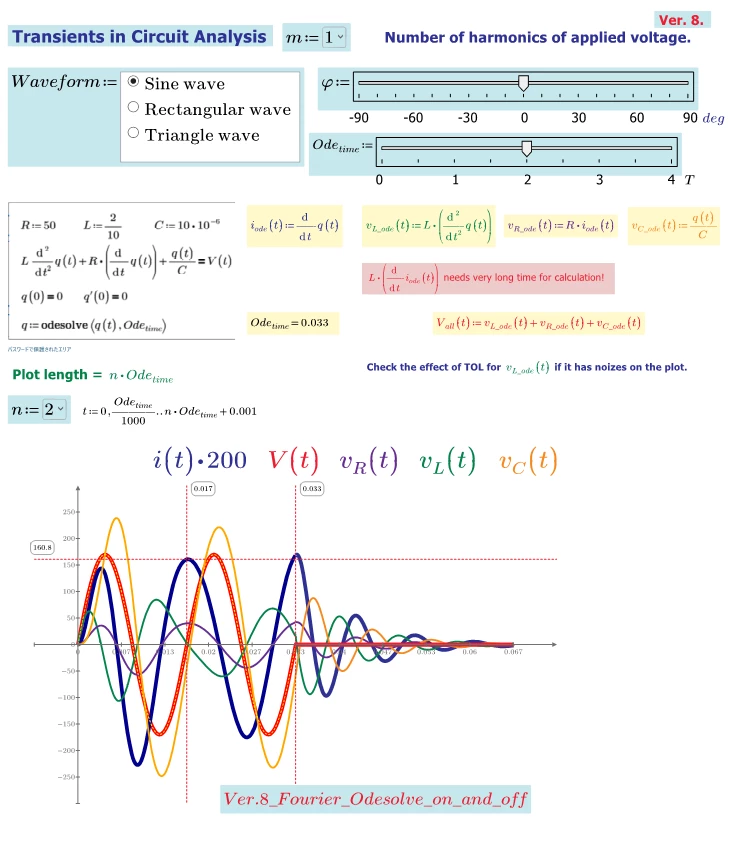

Version 8. Solved by using the Fourier series AC wavefroms on and off responces of Prime 10.0.1.
Most interesting points of this monthes challange are how to treat impulse function and time shift of the plots for on and off of the applied voltage. Therefore, 2 versions with ...1.mcdx sheets have a hidden area to do them. Hope electrical engineers or LTI system engineers to try it.
