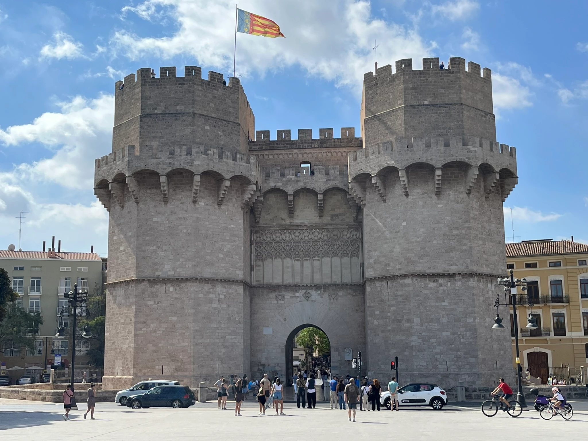

This month’s challenge has a civil engineering theme – actually, a bit of an ancient civil engineering theme related to my adopted home of Valencia, Spain. One of its most famous landmarks is the Torres de Serranos (Serranos Towers), one of the last remnants of its medieval wall:
Torres de Serranos in Valencia, Spain

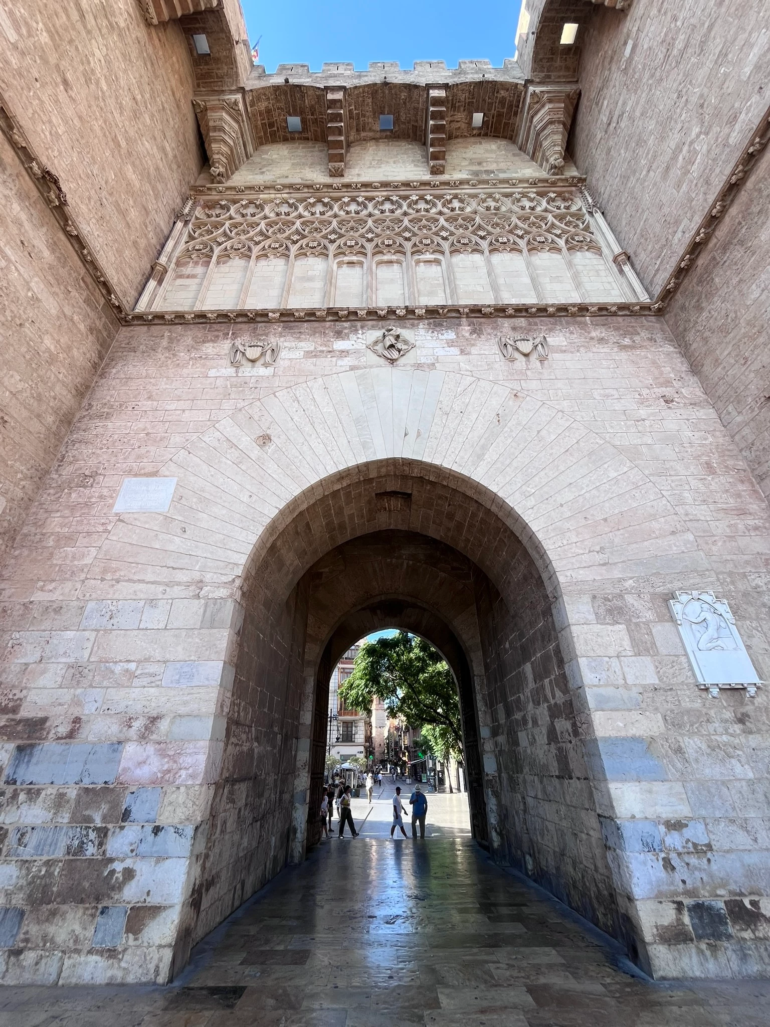

In this challenge, you will perform some of the same calculations that master builder Pere Balaguer worked on in the 1390s. Except, of course, you have the benefit of modern software for engineering calculations. Specifically, you will perform analysis of the Gothic arch at its entrance:
Gothic Arch Gate Entrance to the Torres de Serranos
Dimensions and assumptions:
  • The arch is a classic three-hinged arch mechanism.
  • The span (horizontal width at the opening) is 6 meters.
  • The height from the spring line (where the arch transitions from vertical support and begins its inward curve) to the apex hinge is 4 meters.
  • It carries a uniform dead load from the floor above of 45 kN/m across the horizontal span.
  • The limestone blocks at the base of the arch have a structural thickness (depth into the wall) of 0.80 meters and a joint width along the arch curve of 0.50 meters. (This defines the joint contact area.)
  • The structure is symmetrical.

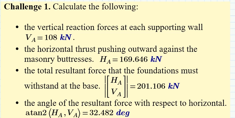

Challenge 1. Calculate the following:
  • the vertical reaction forces at each supporting wall.
  • the horizontal thrust pushing outward against the masonry buttresses.
  • the total resultant force that the foundations must withstand at the base.
  • the angle of the resultant force with respect to horizontal.

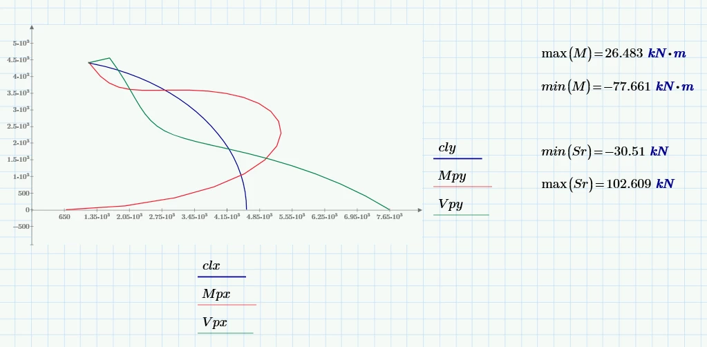

Challenge 3. Use XY Plots or Chart Components to generate a bending moment diagram and/or a shear force diagram for the main gate pointed arch. Feel free to model the arch as either an approximated parabolic curve or a pointed Gothic layout.

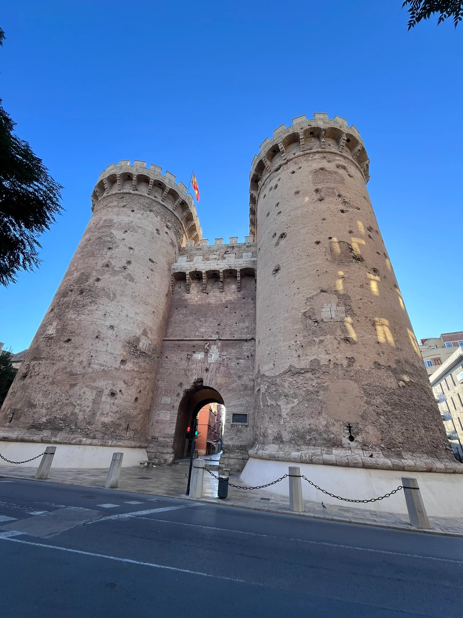

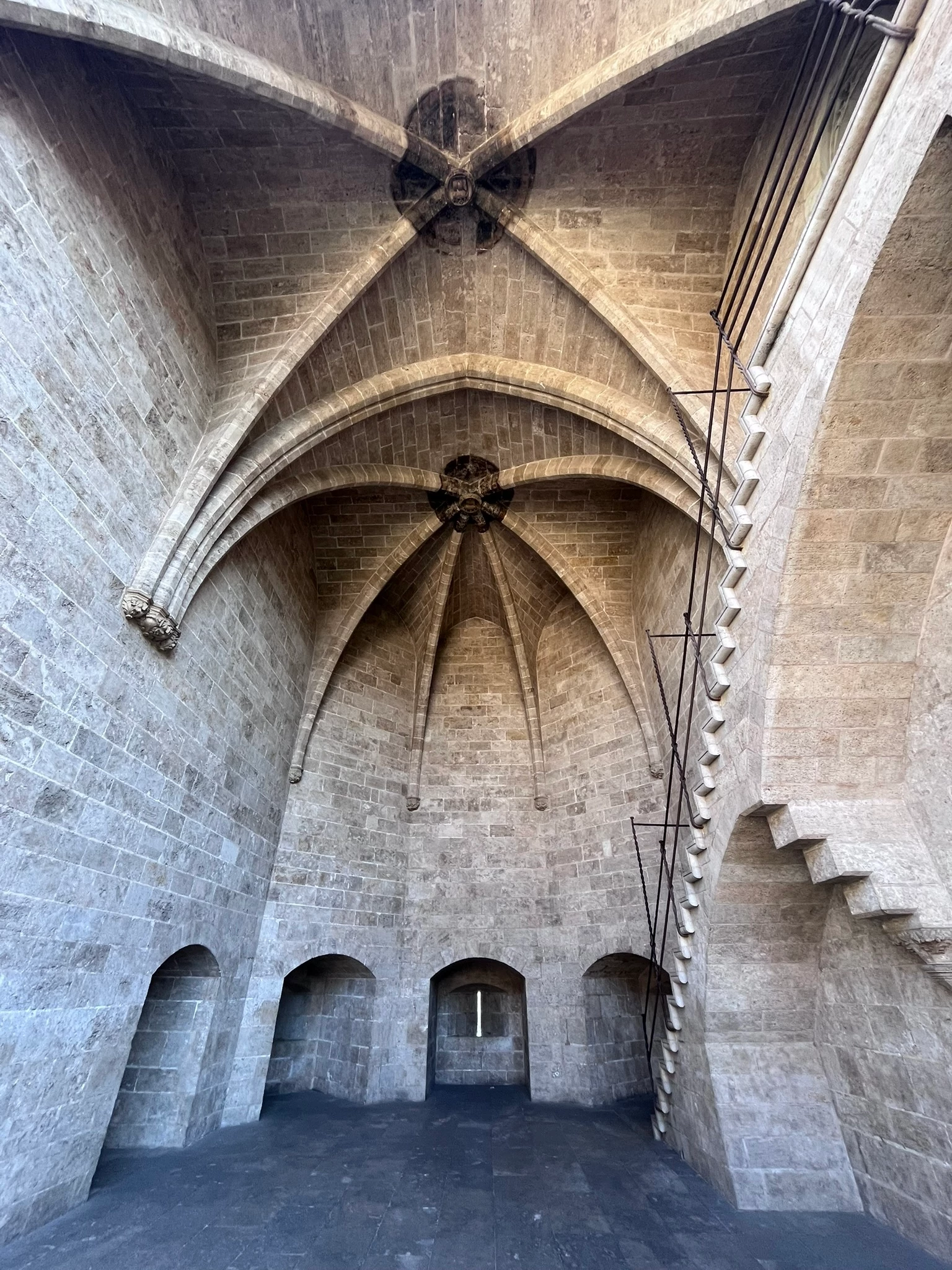

Here are a couple more pictures hopefully to spark some interest. The first is a view of what the interior of the tower looks like. The second is a picture of its twin, the Torres de Quart, which was built about 50 years later on the western approach to the city. The damage on the exterior was from Napoleon’s forces in 1808 during the Peninsular War.
Interior of Torres de Serranos
Torres de Quart

Hi All,
Late in the month but a second submission.  This one shows the power of Prime to do Finite Element Analysis (FEM) of the arch with a trial and error approach.
Cheers
Terry
