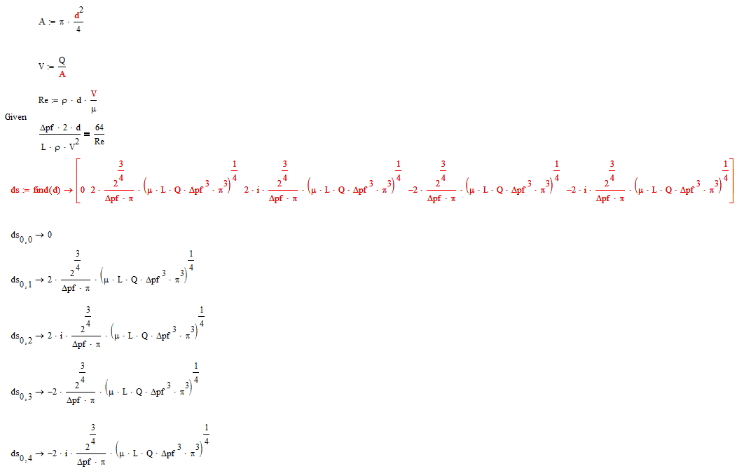

Dear All,
I was trying to solve the variable d, diameter of the pipe.
I could not get the solution. Can any one help me to solve in mathcad.

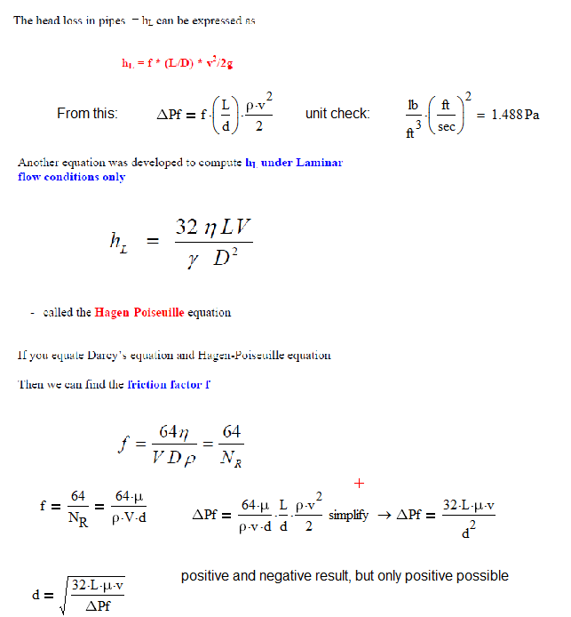

Sorry, I don't like your equations.  Try this:
Note:  LAMINAR FLOW ONLY!!

If you want to solve symbolically, it's better to keep the symbols (by having them undefined), rather than their values.
Besides, the symbolic solver does not work with units, it treats them as (undefined) variables.
Normally assignments (Like V:=Q/A) are not allowed inside a solve block. Only equations (with the bold equals-sign) are.

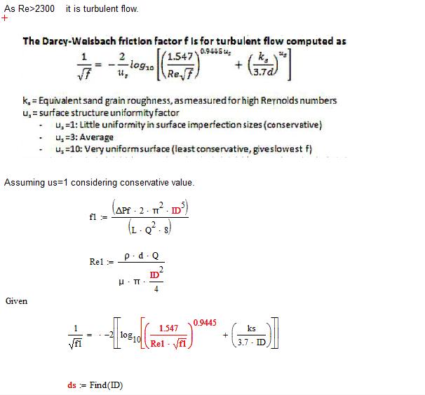

I worked as per your suggestion, I simplified the equation and I got the answer as below.

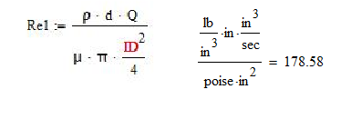

However, as the Re value I found above 2300 , its turbulent flow. I tried to solve these equations to find ID.
I can not simplify here the equations. There fore, I need to go by Solve or Find function. It will be helpful if you can guide here.

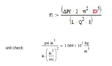

Your units don't balance:
(Reynold's Number does:
So you still have something fundamentally wrong.  If you get Reynold's Number you can approximate the Friction factor.  See Attached

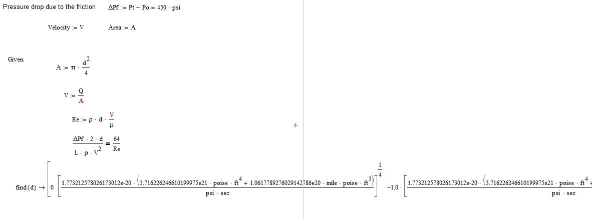

February 23, 2016
Best I can do; given pipe length and pressure drop, find diameter and velocity.  Not thrilled about the accuracy.
