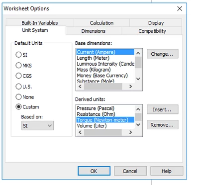

July 10, 2020
There is a way...if you're using real Mathcad, that is Mathcad 15 (or many earlier versions). Simply navigate to the "Tools" menu and select "Worksheet Options", then select "Custom" from the "Default Units" list and then remove "Energy" from the "Derived Units" box and insert "Torque" and set it to Newton-meter...
Now the default will always present the result in N*m units.
Cheers!
