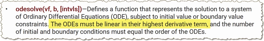

As I had written, it may not be a bug in case of the ODE you provided as the help clearly states that you can only solve ODEs which are linear in the highest order derivative which is not the case in your ODE.
https://support.ptc.com/help/mathcad/r9.0/en/#page/PTC_Mathcad_Help/ode_function.html
I may be wrong and maybe others have some idea to come up with a solution, but I think that unless the symbolic "solve" shown above would finally finish its calculation (I cancelled the operation as it took too long for me) I fear that Prime simply is not able and capable enough to solve your equation 😞
The stand alone solvers like AdamsBDF won't help either as they would require you to explicitly solve the ODE for y2'(t)=....

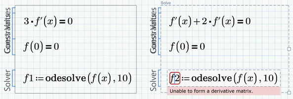

I played around with Method 1 and even by providing a correct IC it did not work.
I guess I tracked it down to a bug in Prime:
Have not succeeded rewriting the ODE in Method 1 so that the bug would not apply
BTW, the bug is already present in Mathcad 15 (error message is "Cannot understand this syntax").

In other words, Mathcad will not simplify the ODE (collecting identical derivatives to simplify the second ODE to the first) as
optimisation of the ODE cannot be set.
