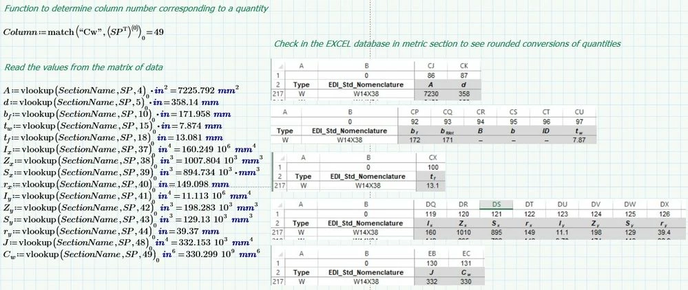

Thanks Luc,
I am trying to do it via READEXCEL but struggling to use Vector & Matrix functions to look for corresponding section property data.
See attached, any ideas?
Kind regards,
Iain

Hi Iain,
The hlookup function (from help):
• hlookup(z, A, r, [modifier | f])—Looks in the first row of matrix A for a given value z, subject to the conditions of the optionalmodifier, and returns the value(s) in the same column(s) in the row specified by r. When the value(s) are returned, they appear in a vector, starting from the left.
In your case for
the parameters to hlookup are:
z=SectionName = the string "W14X38"
A= The matrix SP read via ReadExcel (you didn't provide the Excel file, so I cannot run the sheet)
r= SP<3>The full fourth column of SP, so a vector, where it requires a scalar, pointing to a specific column. Hence the error. Maybe just use '3' here?
[modifier|f] = in you provide a unit instead of a modifier string or function.
The string doesn't appear to be present in the first (top) row of matrrix SP, so a 'not found' error is issued once you correct the Area error...
Study the help to find out how to use the functions.
