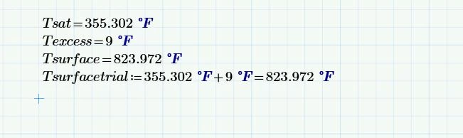

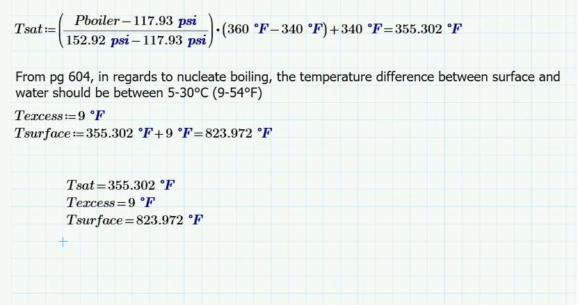

I try adding 355.302°F+9°F which should equal 364°F. However, mathcad keeps giving me 823.972°F. It doesn't care if I use the variables or direct numbers.

You're using the wrong unit for temperature difference.
Note that:
If you add two of those, you end up with temperatures above 500 K.
Use DeltaF for adding/subtracting temperatures.
