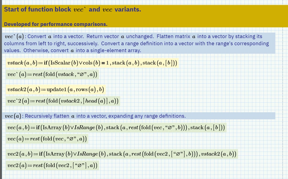

reshape, however, used a vec variant to flatten the target array into a vector, before creating a suitably dimensioned array from the resulting vector, and vec proved to be the reason for the performance problem.
vec uses fold to apply a bespoke stacking function to its input argument.  I wondered if there was a means of speeding it up and tried another undocumented function, update1, to directly insert elements rather than stacking them.  This produced a remarkable increase in speed.
Note that in the definitions below vec` functions only flatten the first level of a nested array, whilst vec variants completely flatten an array, including expanding any nested range variables.
vec` and vec definitions:

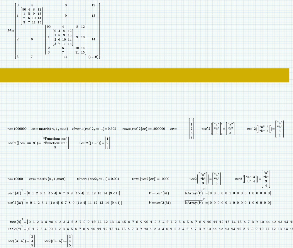

vec` and vec examples:

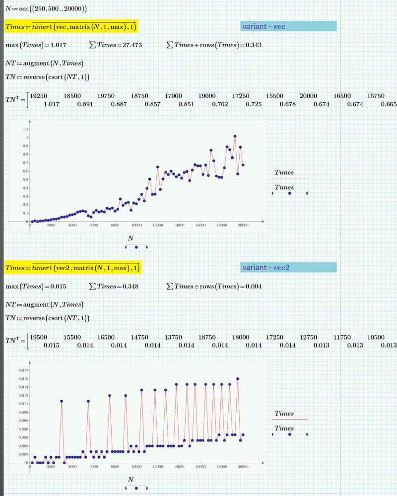

vec performance comparisons:

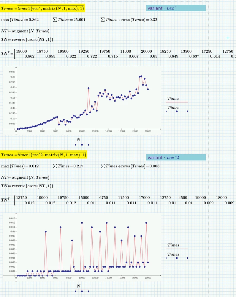

vec` performance comparisons:
