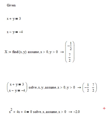

Mathcad fails to provide positive results
Mathcad 15 does not make assumptions in very simple problem for find function and keyword solve to provide only positive results .

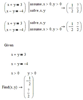

So:
means there is ONE solution, where x=-1/2 and y=7/2.
If you require that both x AND y are positive, Mathcad answers:
I think that's correct.
Mar 10, 2023 1:26 AM UTC
@LucMeekes wrote:
So:
No solution found definitely IS correct.
But what you show is from Mathcad 11 with Maple under the hood.
Mathcad 15 with muPad as symbolic engine actually ignores (as so often) the "assume" modifier or the additional constraints in the solve block and returns a solution not meeting the constraints.
Evaluating the solve block numerically would respect the extra conditions
As usual with solve blocks the error message "This variable is undefined." is misleading and not helpful.
At least MC15 seems to work OK if there actually exists a solution meeting the extra conditions
