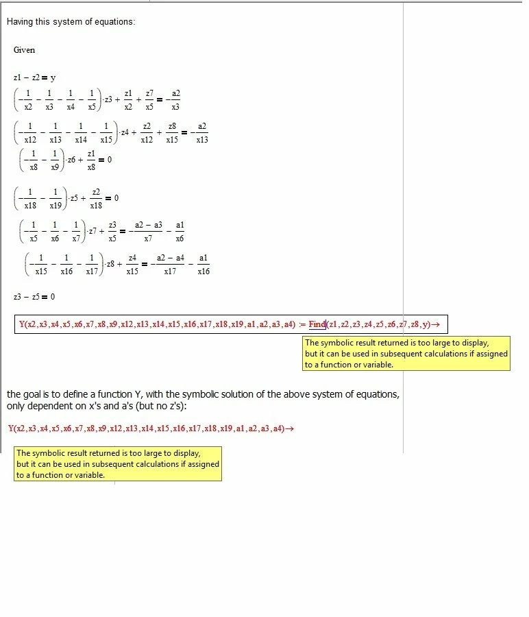

Hello.
Before anything, I got to say that I searched the whole forum for similar questions (which existed), and tried to apply them to my case, but none worked!
I attached files (one is Mathcad15 and the other is Prime 5 file format) with system of equations that I need to solve symbolically, and then attribute this solution to a function.
The system of equations has x's, a's, z's and a y variable.  The goal is to define y as a function of x's and a's, but no z's.
I failed to do it multiple times: sometimes Mathcad just crashs, other times it just says some variables are not defined...
Could someone please help me? This is the first thing I'm ever trying to do using Mathcad!
Thank you very much!

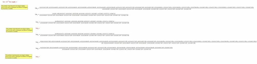

I may have made a mistake in retyping, otherwise your system is not complete. You need to solve for z1 through z8 AND y, you only have 8 equations. You need one more to solve the 9 unknowns:
(Note that the picture is chopped off at the right side. It's very very wide....)

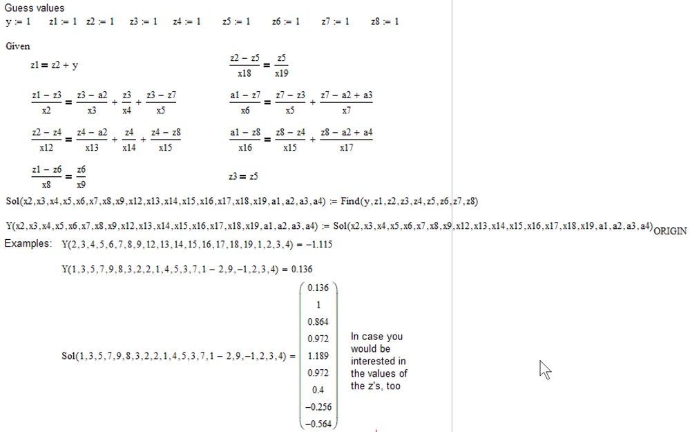

This would mean that you want to solve your system for the eight z's and for y.
That makes nine variables to solve for but only eight equations!
This means that you have one degree of freedom. In other words - the solution(s) probably aren't unique!
To define the Function Y you are looking for, you don't need a symbolic solution of your system. If you are just looking for one of the multiple solutions you may use a parametrized numeric solve block - you'll have to provide suitable guess values if you do so.
February 14, 2019
Here is what i was talking about:
Mathcad 15 file attached

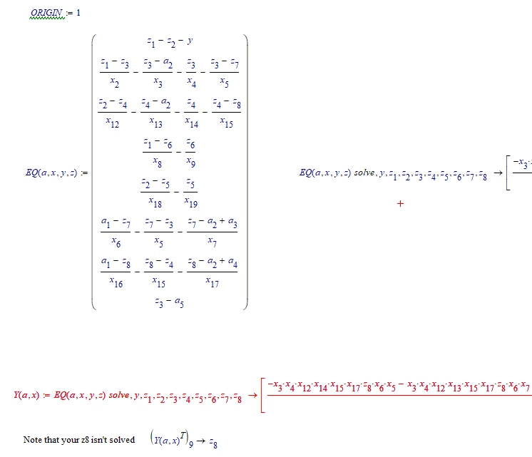

February 15, 2019

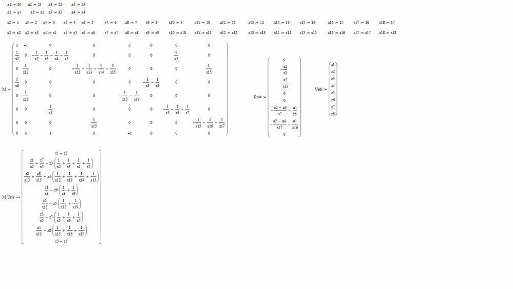

I have considered y a known term. then I continued the calculation like this:
You can do the calculation (here I've considered y as unknown) even so:
waverectifier1-VisitorAuthorAnswer
