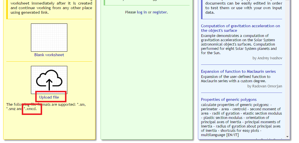

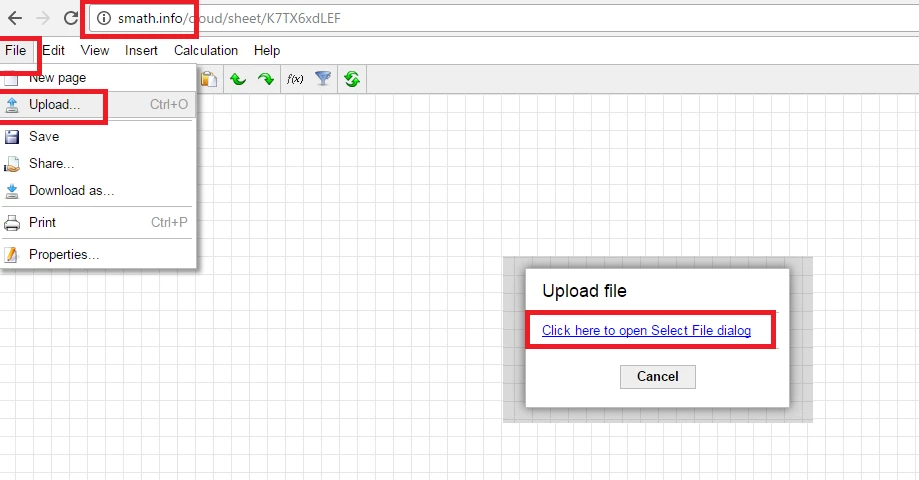

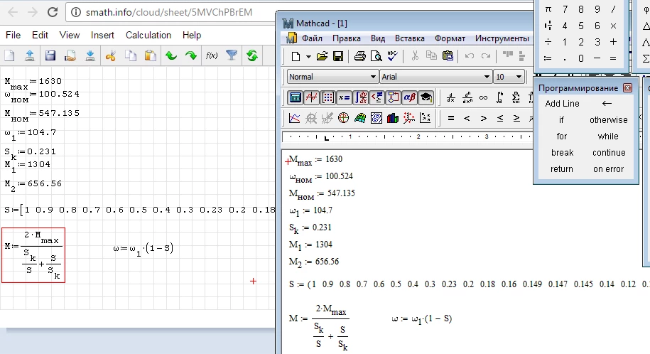

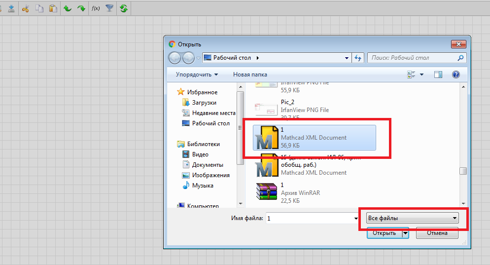

You can use SMath Studio cloud service (through web browser) on tablet/smartphone with Android: http://smath.info/cloud/
