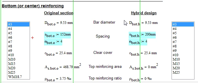

I have a problem with the scriptable drop-down menu object.
If I select a value from the list, and then save the model, the set value will be forgotten by Mathcad upon opening again. And the default value (first one) is set again.
Can this behavior by any method be changed?
Zsolt

The attached should do what you want. Just change the display options.

Wow, thanks, this one works.
Though I have to dug into the script a little bit, as it assigns an incremental value of 1-2-3-4... to the variable, while I want to assign exact values corresponding to bar diameters.
Do you have a solution for the tick-mark (yes/no) object too?
