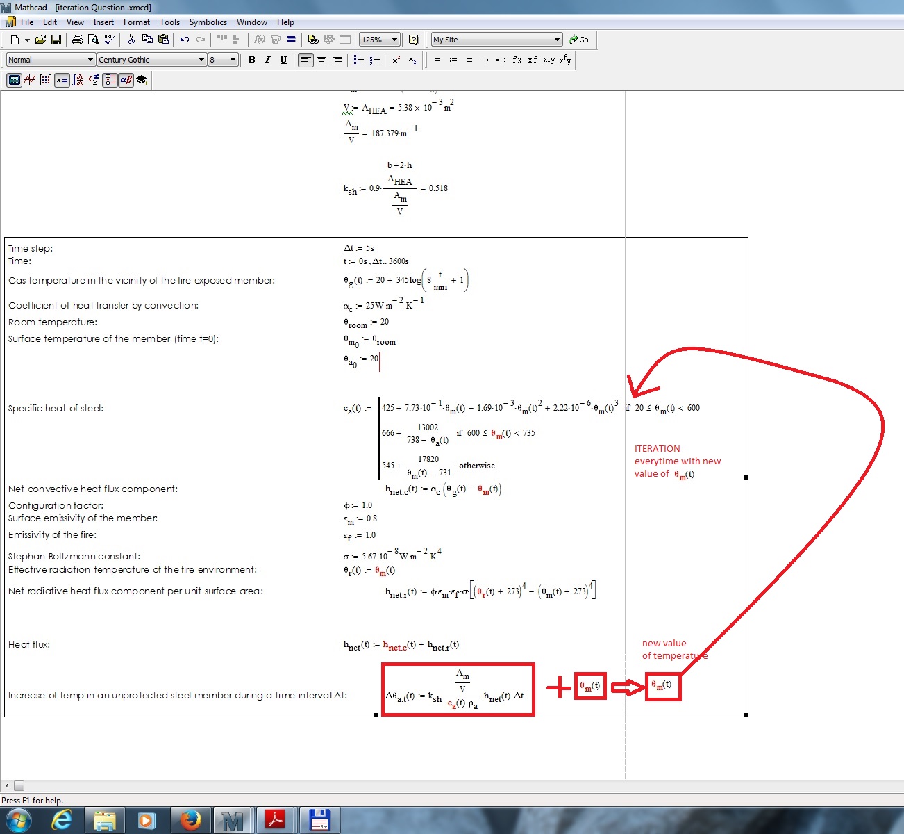

Hi I have a problem with the definition of functions. I have a function A that references to function B which uses function A from a previous iteration.
here's my code (more in xmcd file)
Thank you for your help

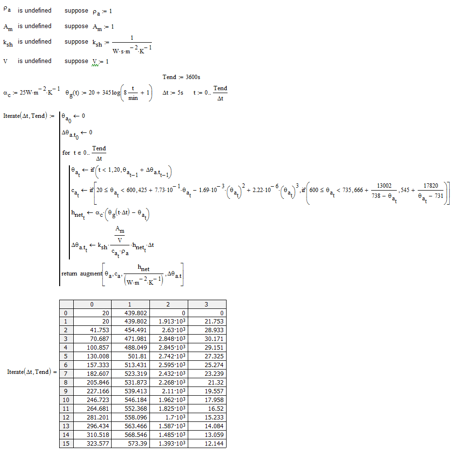

In addition to what Jeff mentioned, there are more problems. You have a number of variables undefined.
I made an attempt to build an iteration. It 'works' in the sense that it iterates, but not knowing the subject my attempt may be far off the intent.
Anyway:
See if this works for you, or if you can make it work.
Note that 't' is no longer time iteself, but an index into the time points (each Delta-t apart).
In the end you get 4 arrays, and to output them simultaneously (using the augment statement), they HAVE use the same unit. I chose unitless, that's why h.net is divided by its units.

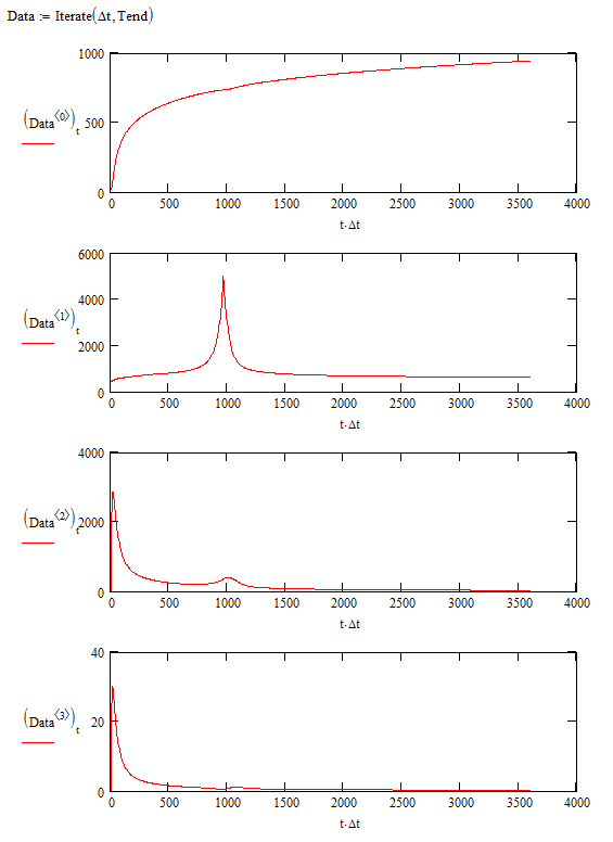

They do result in nice graphs:

just for information: Main point of this calculation is to calculate iteratively increasing of temperature of member from air which is increasing temperature.
edit// I understand that i cant write it like that, also i understand that i have to create iterative loop but i dont have any idea how with such complex problem.
edit2// theres error in picture statement "Effective radiation temperature of the fire environment" in mathcad file its correct

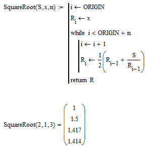

Here's an example to find the square root of S:
You need a starting point for your iteration, the example above uses the initial value x.
And you need a stop criterion, like the number of iterations.

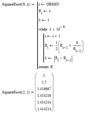

You can also use the difference between two estimates, as shown below:

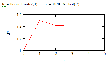

Note that I use an array (R) to hold the iteration values, so I can plot how the iteration reaches its destination:
