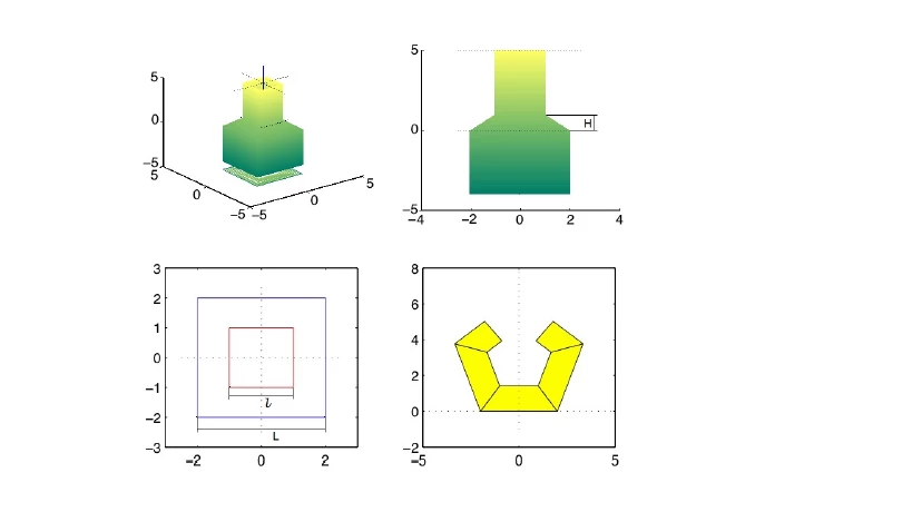

I´ have a problem that i dont understand how make equations for these graphics in mathcad 15, what are on picture and how to make these graphics.
Thank you!

Seems like you should produce such picture in a drawing application. To make them in Mathcad requires sufficient skills.

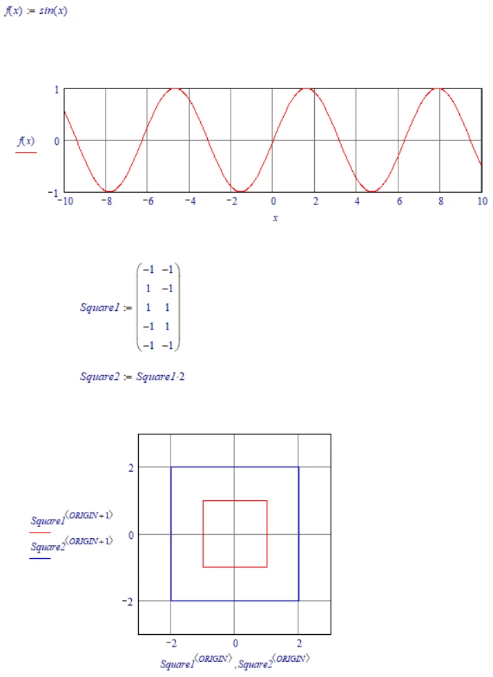

It's easy to crrate a graph of any mathematical function in Mathcad, and also drawing polygon's is easy. I can create with little effort most of your botton-left graph. The part missing is the indication of length ('l' and 'L').
Like wise it is possible to create '3D' plots, with shading etc.
Do you have a (mathematical ! ) description of the items you want to graph?
